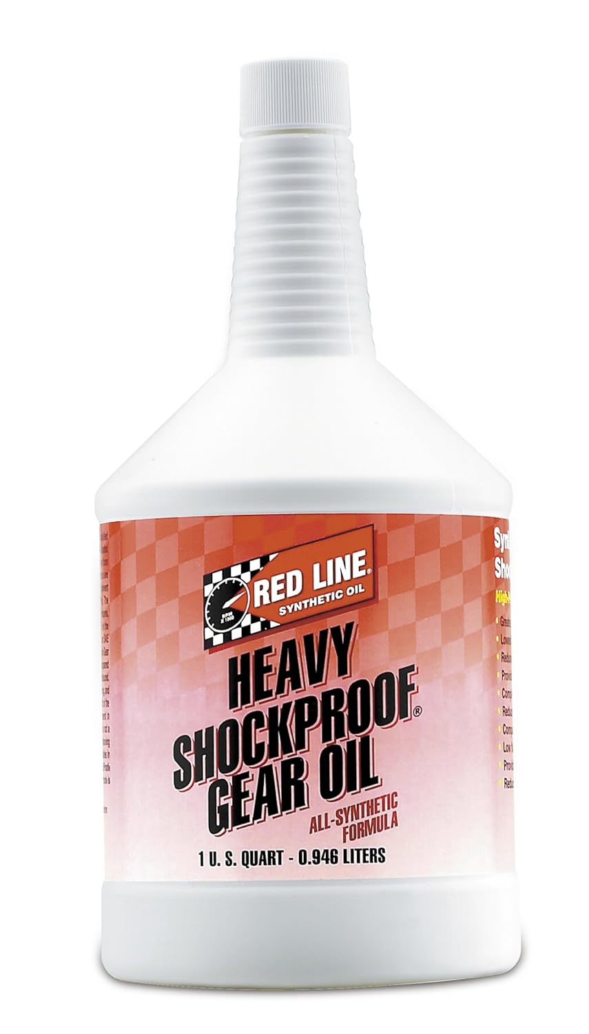

Oil is a religion to some, I like Redline

Nothing wrong with the Amsoil in the motor. Run the gear lube of your choice in the tranny (another Redline Shockproof fan). There are "special" chain case lubes but I have never used one so I can't say they are any better than a conventional 20W50 or 20W40 which I have always used with no issues.

I run Mobil 1 20/50 in engine, Redline shockproof in the tranny and Formula + in the primary and my scoot seems to like all 3.
