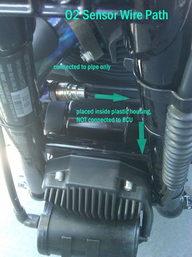

you could remove the O2 sensors from the pipe as the TFI has O2 defeaters installed, but unless you have the correct tool you could damage the delicate Sensor, best to just tie up the wire carefully and leave them in the pipe,

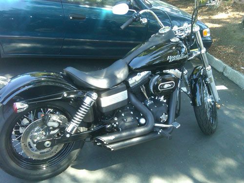

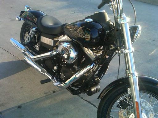

Here are a few pictures of the bike before the mods:

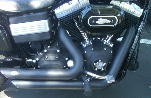

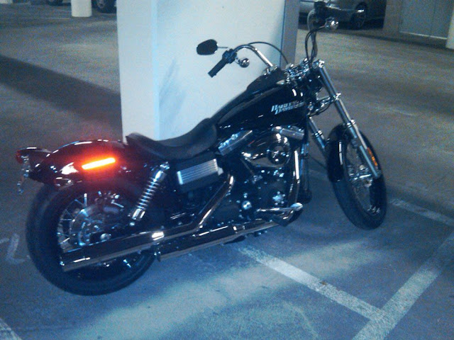

Here are a few after the MODS:
The bike was nice before, but now it's BAD (EDIT)!!!!!!

Goveside45: Nice bike. Feels good when all the work is done and the results are what you wanted and expected. Enjoy! Enjoy! Enjoy!.
Gene
Got the same pipes in place, high flow filter as well but hidden under the football, this will change soon enough :)
Happy for you the job went well!
Now enjoy the ride!
