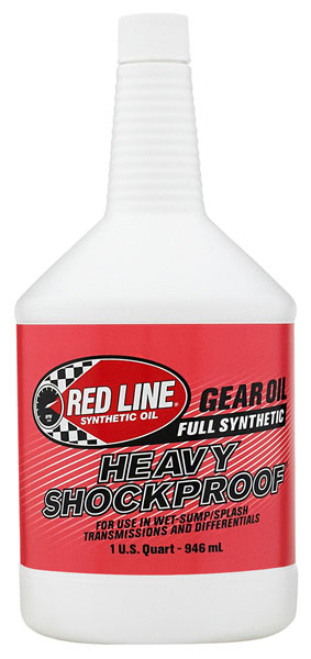

My local hot rod shop has RedLine I told him I wanted grade 4 he said he has heavy or light wt. how do I know what I need for a 5 Speed:hii
Redline shockproof HEAVY.
