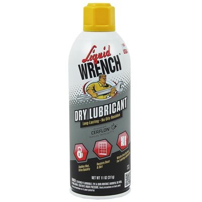

I'm going to remove the brake lever again and clean up all around and inside the brake lever housing. I will remove all lubricants (oil, etc.) around the pivot bolt, etc. and not lub anything. I will try using it dry and see if it retracts. Just maybe there is too much light oil causing the lever a bit of resistance. I should find some kind of "dry" lubricant. Anyone have any good suggestions for a dry lubricant?
There's several out there, but I haven't tried any for that application myself. AutoZone has this one I have seen locally...
