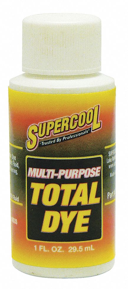

4LTU8_AS01
If you are not sure, try this you can find it @ Graingers, Auto Zone and others:Add a bit to your oil to be sure it is not the leak
