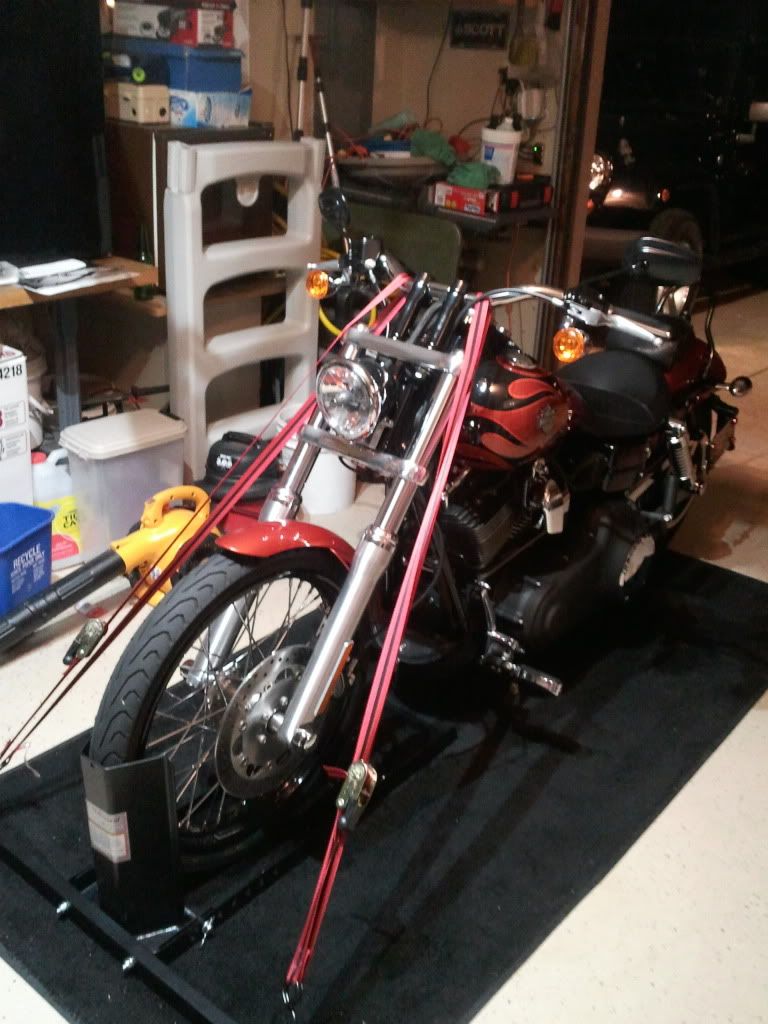

Hello, I just picked up a wheel chock from Harbor freight and I am using tie downs because the bike wont stay in chock by its own for more than 5 minutes. I would like to store the bike over winter this way. Am I doing any harm to the front suspension by having the bike strapped down for long periods?
Don't tighten the straps too tight. When the front suspension starts to compress that should be enough, especially if the bike stays stationary for the winter.
Ken
Don't think you should have any problems with the light pressure kemo spoke of. I would move the tie downs to just above the lower triple tree, no sense putting strain on the handlebars.
You can also put the kick stand down and shim under it with blocks of wood
I totally agree with this. It's how I always stabilize and transport a bike.
As others mentioned, light pressure shouldn't hurt anything. I prefer to attach the staps to the bracket were the fender joins the forks, that way no compression is on the fork tubes.
