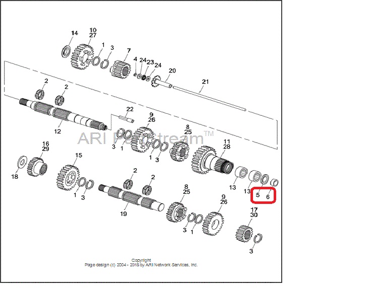

  1. If you don't have a service manual I would suggest you get one. I have attached 2 pics for what Dolt is talking about. In pic1 is the seal, item 5 is p/n12035B and IPb race, item 6 p/n 34091-85A.

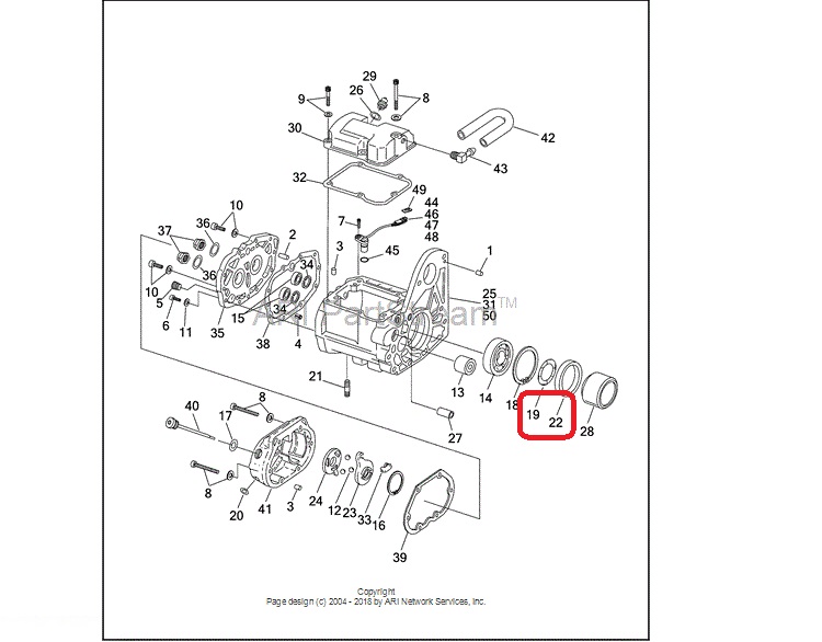

    In pic 2 item 19 is a quad seal, p/n11165 and item 22 is a seal, p/n 12067B. There is also a spacing between #6 and # 11. I believe it is .100"-.200". It also requires a special tool for removal & installation.
    Pic 1
    Pic 2

    Agree with Pete, when you dig into it I would suggest changing all the seals as long as you're in there. Check these photos out as well.
